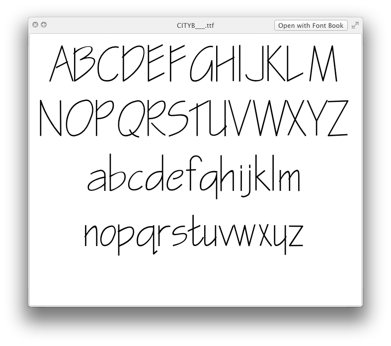

    Not sure about ALL, but some of the TTF fonts really doesn't appears in AutoCAD for Mac. In my experience, those are an old one fonts, for example CityBlueprint font from 1996 year.
    If you Quickview such font in Finder, you will see something like this:
    And here is the same font, modified with FontLab Studio:
    The last works well with AutoCAD for Mac.
