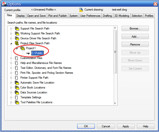

I'm having a bit of trouble with AutoCAD for Mac and opening xrefs over a network.  Specifically, if I have a file open in ACAD for Mac on my machine and someone else using ACAD for Windows tries to open up a file that references the file I have open, that xref will not display on their screen.  If I close the file and they re-open the file that references the file I just closed, it shows up just fine.  It does the same thing in the opposite direction as well - if I try to open a file that contains an xref opened on a Windows machine, it won't show up either.  If I try to directly open up another file that someone else has open, I do receive the appropriate read-only dialog window.  We're using a MacMini Server w/ OS X 10.6 Server and running Windows with the newest version of Parallels if that makes any difference.  Thanks!

So far I've managed to understand that this is caused due to the different path names that exist in the same network: e.g. (windows pc running in a windows server network) "\\server\projects\2011\xref" and (mac pc running in a windows server network) "volumes/server/project/2011/xref".
If the mac user saves his system path, all other users wont be able to open acad files with xref correctly attached and the same happens when the opposite occurs.

You can use a Project name in your drawings.
From AutoCAD 2011 (for Windows) help:
"Use Project Names to Define Referenced Drawing Paths
Project names make it easier for you to manage xrefs when drawings are exchanged between customers or if you have different drive mappings to the same location on a server. The project name points to a section in the registry that can contain one or more search paths for each project name defined.
If the program cannot find an xref at the location specified by the search path, the prefix (if any) is stripped from the path. If the drawing has a PROJECTNAME value set and a corresponding entry exists in the registry, the program searches for the file along the project search paths. If the xref still is not located, the program search path is searched again.
You can add, remove, or modify the project names that exist in the registry. The folder search paths beneath the project name can also be added, removed, or modified.
The search paths beneath the project name can be added, removed, or modified in the same manner as the project name. The order in which the folders are searched can also be modified. Projects and their search paths can only be edited through the Files tab in the Options dialog box. You cannot edit project names at the Command prompt.
Once you have established a project name and the search paths you want associated with that project name, you can make that project name the currently active project. The program searches the paths associated with that currently active project for xrefs that were not found in the current folder of the host drawing, the full search path, the current drawing folder, or the program support paths."
So you have to add Project(s) in AutoCAD for Mac Application Preferences (1 Application Tab -> 2 Project Files Search Path -> 3 + (at the buttom of dialog) -> 4 name your project (or leave default "Project1") -> 5 Open "Project1" -> 6 Select "Empty" entry -> 7 Select "Change Path" and point to your "volumes/server/project/2011/xref" folder (in my case it is another name)
So, on Mac side you have:
Then open your drawing, open Application Preferences, select "Project1" and select "Set Current" from "gear" button. Now PROJECTNAME sytem variable in your DWG is "Project1", and it is saved with DWG file.
Then you can insert Xrefs in drawing (even with "No Path" option")
On Windows side create the Project in Options with the same name as in Mac and in you drawing ("Project1") and set the path for this project "\\server\projects\2011\xref" (in my case it is another name):
Now if you open your DWG with Xrefs on Mac or on Windows - AutoCAD will search Xrefs in the Project Files Search Path, ie in "\\server\projects\2011\xref" on Windows and in "volumes/server/project/2011/xref" on Mac, in fact the both paths points to the same place, and we were"told" about this to AutoCAD through the Project feature.
