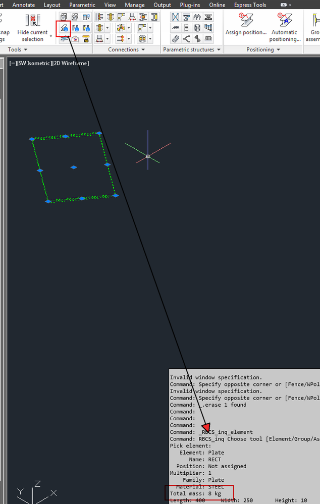

I had a problem in ADS Steel bill list. when I create bill list or plate list
, weight of the plates are not correct.  Like the image !!! What can I do for fixing ?
Please help me.
Thank you.

In similar situation this was a material problem. Change material of plates.
If you click on plate (in model) and check its information - you see that its weight is 0.

Dear Priitl220,
I have tried to change material of plate when I saw this problem. But unfortunately noting is change.
Thank you for your suggestion.

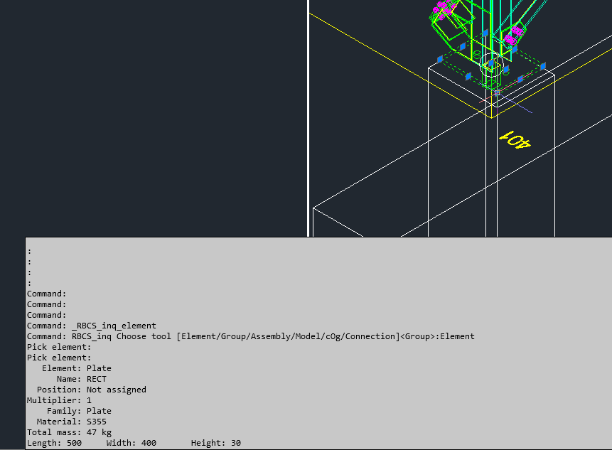

in reply to: Anonymous
Changed material to s355 and its ok.
Thank you very muck. I did.
