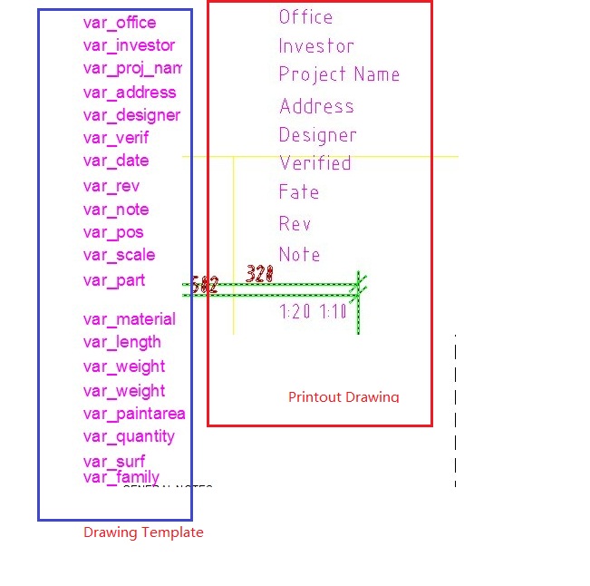

    I am new to study Structural Detailing. Just now I finished the module guide. Can someone help me several questions below? Thanks
    1. The elevation heights are not shown. I can't remmeber I changed something about it. how to get it displayed?
    2. How to add a fill plate (Just small one, 3/8" x3" x3", to fill the gap between angle bracings) at the intersection of cross bracings?
    3. If I want (2) rows of bolts on angle bracing, how?? I didn't see the options.
    4. To adjust the shape of plates, it's hard to drag to the right point, even I set all 2D/3D snap modes on. I use Relative coordinates to affirm. Do you have a better idea?
    5. Printout template. Why I can't use the text variables except for those in project infomation tab? (see picture attached).

    1)  You can find elevation marks in "Dimmensioning Styles" (see Atachment "Elevation mark"), or you can add it manualy. Note that it shows wrong values (decimeters instead of milimeteres).
    2) Just create a plate and place it manualy. The Bracing macro doesn't have this option.
    3) Manualy. It can't be done by macro. Hope for future development.
    4) I set the UCS on the top/botom of the plate,  create a polyline that looks like wha I need and then drag the edges of the plate. Or you can just create the plate based on the polyline that was created earlier.
    5) I don't know the answer.
