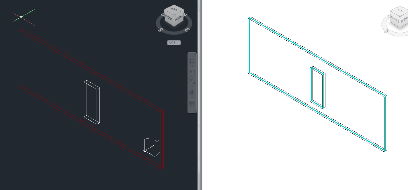

Hi All,
Againg on the same problem. If you have a simple wall with a door, the door will be not exported:

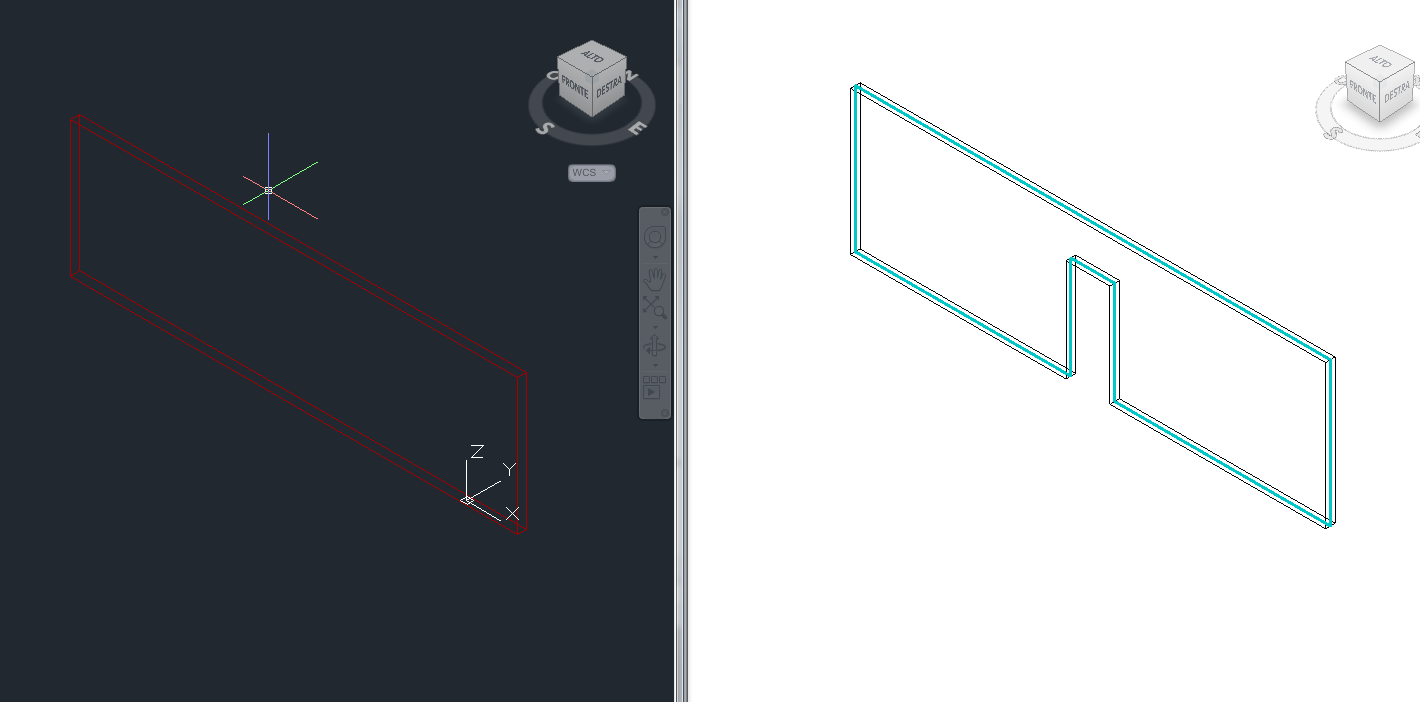

Anyway if you change the Heigth of the wall as shown inthe picture.
thanks
Message 8 of 8
I can confirm it.
Sent to analyse.
