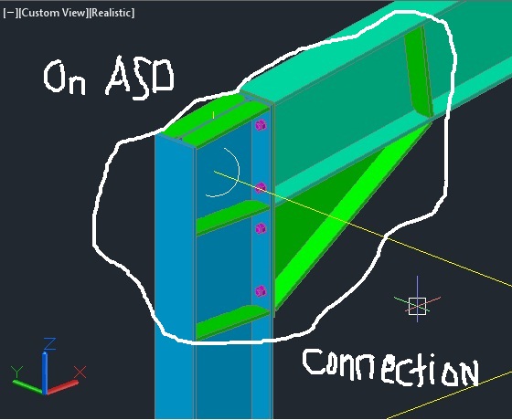

I'm drawing a frame sructure on ASD (Autocad Structual Detailing). I linked the fame to Robot Structual Analysis. However, connection of the frame on ASD didn't convert to RSA (see attached). Please show me how resolve it?ASDRSA

Unfortunately, thre is nothing to help with in such functionality.
Connections are migrated in backward model transfer, fron RSA to ASD.
It is just because the most common workflow was from calculation and code design model to drafting one.
Opposite workflow was not developed in such way.

One more thing. In RSA you can't add the second Stiffner (the one from the Beam's lower flange), so the Connection is not Exactly the same.

Truly said, in case of this kind of connection with brackets, this stiffener is not so important for connection strength.

I have a different opinion. When Robot calculates the connection accordin to EC3,  the Shear Panel relations take in consideration the distance between stiffners.
So if you have a stiffner in the middle of the Column Web that connects the flanges, the Aria to be taken in consideration is half.
Am I missing something?

I know a formula that says:
t.w=>(d.p+h.ws)/90
t.w= is the thickness of the column web (and additional plates)
d.p= the distance between the stiffners
h.ws= the height of the columns web.
Also you can check a connection in Robot that doesn't satisfies the code : "Web panel - shear". Add an inclined stiffner (this option exists) and usually it solves the problem.

Answering on questions ASD to RSA link questions:
  1. Link made an automatic placement of elements on space. Some of them like purlinks on rafters are analytically linked but RSA does not confirm it while elements has no common nodes. When it happens (like elements laying on other)  it needs that nodes to be connected by Rigid Link. This is not phisical, the geometrical dependency of displacement between the nodes. Here in such situation it was generated automatically.
  2. I assume that during link definition you left the Plates->Panels check box option OFF (as default). Please try with ON and define the material of plates. Be careful leaving the default structure type as Frame 3D in RSA. With plates it should be Shell.
  3. It seems like the structure is not consistent or unstable. It never is possible to guess by this error. Must be checked. On my simple default test (I assume very close to yours) my structure was full of short elements acting the bended bolts of connections. It might be the geometrical disorders' sign of such linked model.
