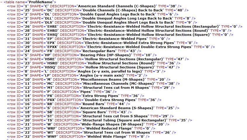

Thanks a lot for your response. I have created a 1200*500 RHS section with thickness 25mm by creating region, and with the option of saving profile "inDatabase", I have saved the profile with the name"RHS" in "AISC2" database and saved it. I have opened the Aisc2.xml file from C:\ProgramData\Autodesk\Structural\Common Data\2012\Data\Prof, but i couldn't find the saved RHS profile there. see the images....asd_2.JPG
Do you know where can I find the required xml file? I would be glad to hear more suggestions from you.

Generally the profile will save in an xml file called "ruser.xml" try this file and see if you can find the saved profile. It should be in the same place as the other xml you mentioned but it could also be in your USER/APP DATA/AUTODESK/STRUCTURAL
Give this a go andd let me know
