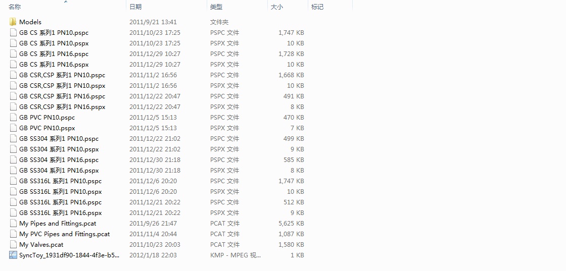

    I copied the whole folder "C:\Autocad Plant 3D content" to another computer. The folder in destination computer is also "C:\Autocad Plant 3D content". I checked two computers in Spec Editor menu, the shared content folder were both "C:\AutoCAD Plant 3D 2012 Content".
    Below is my folder structure:
    Catalogs are in "\CPak GB":
    My  drawing with blocks are in "\Models".
    I searched for the longhexnumer drawings throughout the C:\Autocad Plant 3D contens folder. Nothing was found.
    Where is they?  Why it works well in modeling pipe without longhexnumber drawings and 200 and dwg folder?
