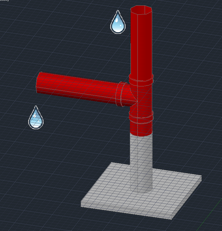

    I'm a Plant 3D newbie.  We use the attached support quite a bit.  I'm not sure how to build this within P3D.  One thing I have tried is to create an AutoCAD entity and convert it to a pipe support.  This will attach it to the SW tee, but I'll still have the "drip" symbol.
    Any suggestions would be appreciated.

    Can you provide a screen shot of what you have converted to pipe support? I would like to see where the "drip", disconnect marker, is being placed.

    Attached is a JPG.
    My process for creating the support was to make an AutoCAD object, move it to the location, then use the PLANTPIPESUPPORTCONVERT command and chose the socket of the tee as the insertion point.

    I am sorry I did not get back to you before now. The easiest thing to do would be, for the threaded 3 way tee is just to place a plug. Then you could model your our support and convert support. This would also apply if you are using a SW tee.
    However, then you would have a plug that would show up in you BOM. The other option would be is the generate a custom tee with one end plugged.
    You can refer to this web link on creating Custom Companents.
    http://www.pdoteam.com/2011/10/custom-components-in-autocad-plant-3d/

    Hello Quentin.  I finally got around to trying one of your suggestions.  I took a round plug and changed it's size to mimic a 4" long piece of round bar.  This seems to fix the "drip" connection.  As soon as I attach my pipe support to the plug, the "drip" reappears, but is only visable if you select the support.
    For the iso's, I can probably just create a new iso symbol for the round bar so that it includes the "duck" and then just fake the duck in the model.  If that makes sense.
