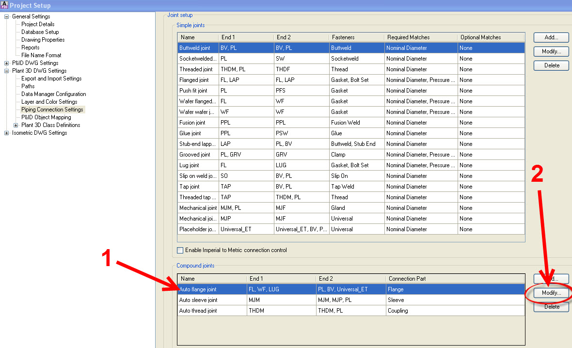

    I'm completely stumped on this one.  I'm having a terrible time trying to get a stub end & lap joint flange place in my model. I've been somewhat successful in getting a stub end/lap joint flange to connect to another stub-end/lap joing flange but the problem comes when I try to connect to an equipment nozzle or valve.  From all of the other posts I see everyone says it should work out of the box but I'm having no luck.  Here's where I'm at:
    Created a new spec taking the only stub ends and lap joint flanges available in ASME Pipe & Fittings catalog.  I can't find anything anywhere that tells me which bolts and gaskets I need to make a lap joint connection so in this spec I added every bolt and gasket available.  So what I'm saying is that I've got everything in the spec.
    Lap joints won't connect to other lap joints or to valves or nozzles.  Here's the error I'm receiving when trying to continue routing from a ball valve::
    Started hacking around with the Joint Setup dialog and was finally able to get lap joints to connect to other lap joints.  Still can't connect to the valves.
    Can someone please tell me exactly what my joint settings need to be?  I've attached a pic of how my settings are right now.
    Thanks!!
    Bob

    Does your spec have a flange in it that meets the following criteria?
    NominalDiameter = "2in"
    Primary port facing = "RF"
    Primary port end type = "FL"
    Primary port pressure class = "150"
    The flange that is found will get connected on two sides.
    Primary port: Will match the valve or nozzle you are connecting to
    Secondary port: Against pipe or other pipe fitting.
    So take a look at how many flanges meet that search criteria to see if an unexpected flange (secondary port) is being used.

    No, I don't have those items.  The problem is that the ASME catalog that shipped with P3D doesn't have RF lap joint flanges or stub ends.  My assumption was that P3D was programmed to only use FF for these two items so I didn't bother creating new components.
    However, shouldn't it disregard the facing  connect a RF to a FF since I removed the Facing from the Required Match section of my flanged joint in joint setup?
    But even with the FF stub ends and lap joints they wouldn't insert or connect until I messed around with the Joint Setup. Can you confirm that my Joint Setup is correct?
    In the mean time I'll try creating RF stub ends and lap joints.

    You can change the Autoflange search criteria in Project Setup so that you do not need to define new content. It is looking for a flange using those values and it is failing because it can't find it in spec. You have two choices:
    1. Add flanges to spec
    2. Change flange search criteria of Autoflange for the project
    Hope this helps.
    --Jorge

    It does help.  Can you direct me on how to change my Autoflange criteria?  I thought of that but couldn't figure out how to do it.
    Bob

    Click the button "..." shown at:
    http://docs.autodesk.com/PNID/2013/ENU/filesPCRD/GUID-C0E1E094-228C-4E11-A642-5E1B4968174C.htm
    And it should bring up:
    http://docs.autodesk.com/PNID/2013/ENU/filesPCRD/GUID-68A4205B-9395-4112-9510-B958DDAF7970.htm
    This is where you change the matching properties that affect the flange that is searched in the spec.
    The UI is a little confusing:
    Simple joints = actual connections
    Complex joints = adapter search
    When a complex joint is used to find an adapter, one simple joint will be used at each side of the adapter.

    Your instructions helped but I also had to add Stub Ends as a fastener.  Thank you for your help.
    To add Lap Joint flanges and Stub Ends to work I did the following:
    First go to Project Setup > Piping Connection Settings.  Click on the "Auto flange joint" under Compound Joints, then click Modify:
    In the Setup Compound Joint dialog, click on the "..." button as shown below:
    And finally uncheck the "Facing" box:
    This will allow you to connect RF and FF flanges to each other.
    But that only fixes the problem of having only FF lap joints and stub ends in the catalog.  Because the stub ends are considered fasteners I had to also add them to the fasteners for Stub end lapped joints as shown below:
