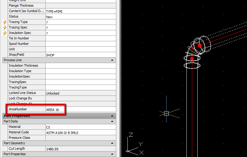

    I finally a solution for adding the area number behind the line number on the Isometric drawings.
    This requires some configuration inside the IsoConfig.xml and the Iso.atr files for your Isometric style.
    These files can be found in the sub-folder of Isometric in your project, for example:
    C:\Projects\Project Name\Isometric\Final_A3\IsoConfig.xml
    C:\Projects\Project Name\Isometric\Final_A3\Iso.atr
    In testing, I created a new P3dLineGroup property in Project Setup and called it "AreaNumber"
    I modified the Iso.atr using Windows Notepad to include the following (be sure to turn off word wrap option in Notepad):
    ATTRIBUTES
    Attribute1 P3dLineGroup.Service
    Attribute2 P3dLineGroup.NominalSpec
    Attribute3 P3dLineGroup.InsulationThickness
    Attribute4 P3dLineGroup.InsulationSpec
    Attribute5 Drawing.Unit
    Attribute6 General.Project_Number
    Attribute7 P3dLineGroup.LineNumber
    Attribute8 General.Project_Name
    Attribute9 General.Project_Description
    Attribute10 P3dLineGroup.AreaNumber
    BOM-ATTRIBUTES
    EngineeringItems.Schedule
    EngineeringItems.PressureClass
    EngineeringItems.Material
    EngineeringItems.PartSizeLongDesc
    Next, I opened IsoConfig.xml and searched for "LineNumberScheme" (click "Find Next" button twice and you should be at the proper location in the file)
    I made the following changes for the default line number annotation scheme:
    Default configuration
    <LineNumberScheme Name="LineNumber" AnnotationStyle="Standard" Format="{0}-{1}" Alignment="SkewAligned" LeaderStyle="AsNeeded" ComponentFields="Size PIPING-SPEC" LineFields="PIPELINE-REFERENCE" ComponentFormat="{0}-{1}" LineFormat="{0}" />
    Modified configuration
    <LineNumberScheme Name="LineNumber" AnnotationStyle="Standard" Format="{1}-{0}" Alignment="SkewAligned" LeaderStyle="AsNeeded" ComponentFields="Size PIPING-SPEC" LineFields="PIPELINE-REFERENCE ATTRIBUTE10" ComponentFormat="{0}-{1}" LineFormat="{0}-{1}" />
    Basically switching the formar around so the Line Fields show up after the Component Fields and then adding the additional entry for the LineFormat so it would include the new ATTRIBUTE10.
    One thing to note; if you do not type in a value for the Area Number in the Process Line properties, nothing will show up for the line number in the Iso drawing. You can enter a "." or any character as a placeholder so the line number will still generate.
