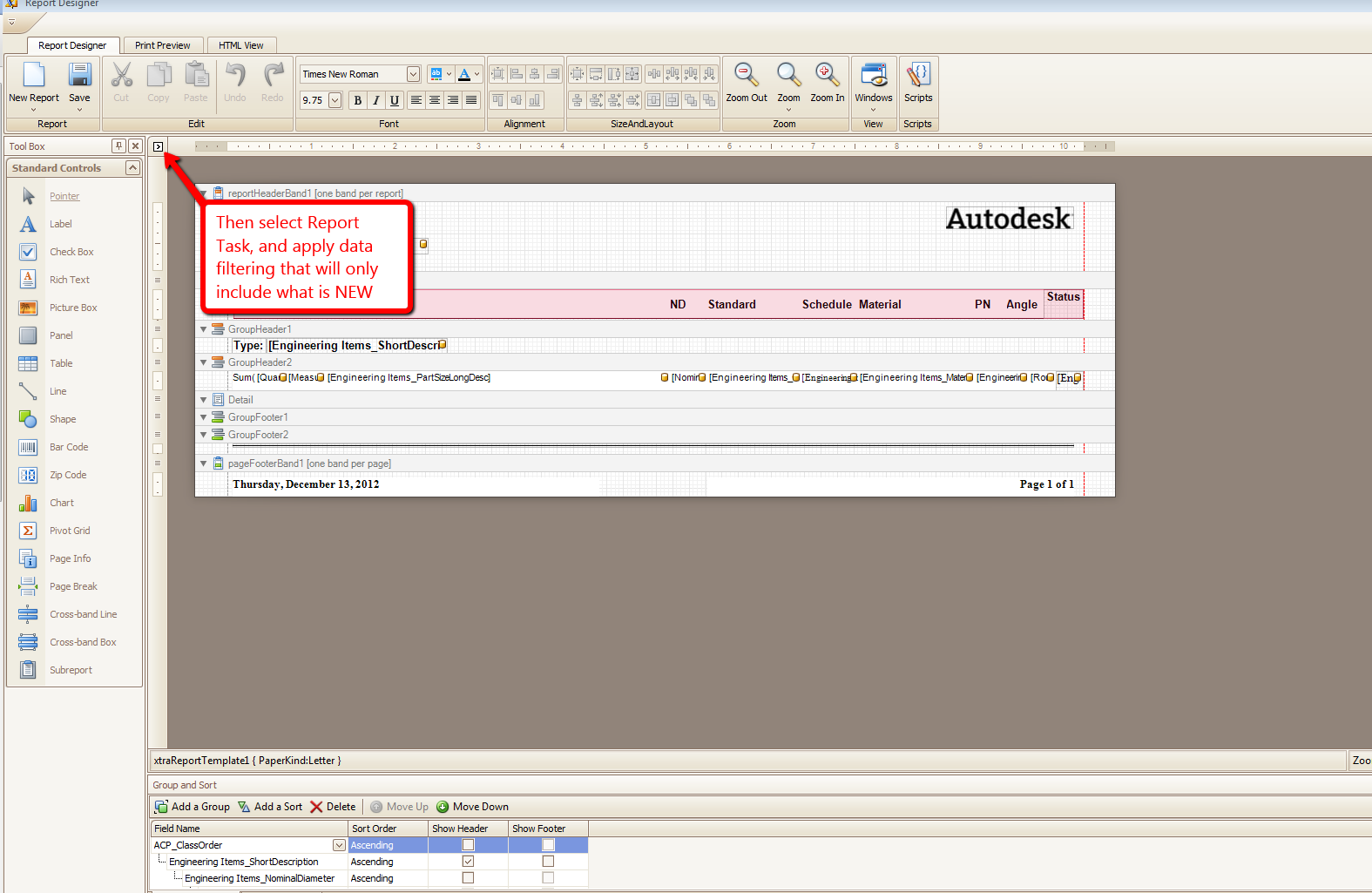

I have a problem with Report Generator that i can't figure out. I am currently in a project where I am connecting to existing pipes. I have modeled these existing pipes but I don't want them in my MTO (of course). I have set the properties for these pipes to "existing" but the still appear in the MTO. The total length of pipes is too much.
How do I exclude pipes and other equipment from the MTO automatically?

First, do you have access to the Report Designer Manual? Please refer to this forum link and the post by Jason Drew, he provides a link to access the manual.
http://forums.autodesk.com/t5/AutoCAD-Plant-3D/Report-Creator/td-p/.UMpZaG_Ae_w
The field I used in the Pipe properties was Status. There you can assign the pipe as either New, Existing or Demolition.
Then, I opened Report Creator and I created a new report based off of my existing 3D Parts report. You can either generate a new one or base it off another existing report depending what you are wanting to do. Then I selected Edit and Edit Report layout. I added a new column to include the status.
You will then need to setup a filter. This filter will only place the New items you set in the Status.
Now I will run the default 3D Parts report. Pay notice to the total pipe lengths.
Now the new report that filters Status for New items.
Hopefully, this guides you in the direction you needed.

I exclude (filter on Not equal to) the items with status "Existing" and it seems to work.
This gives me the benefit that I don't have to mark all my items as New but only mark the Item that are Existing.
