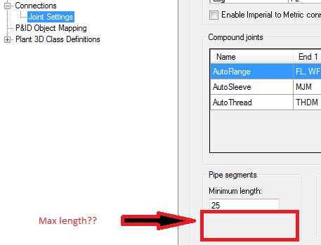

    Is there a way I set a limit for piping to never exceed 40 ft or some other number?

    It's true. Is nesessary to do like this in next release:
    And install flange connection automatically every max length.

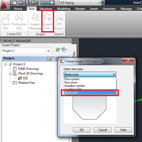

    What I was actually looking for was a way for the length of pipe to be no more then 40 ft, but then get welded onto another pipe in the iso drawing. The closest I can get to it right now is inserting a break at the 40 ft mark and hope people realize that they needs to be a weld there. I just have to figure out how to get the break to be at exactly 40 ft, and for the ISO to show that measurement.

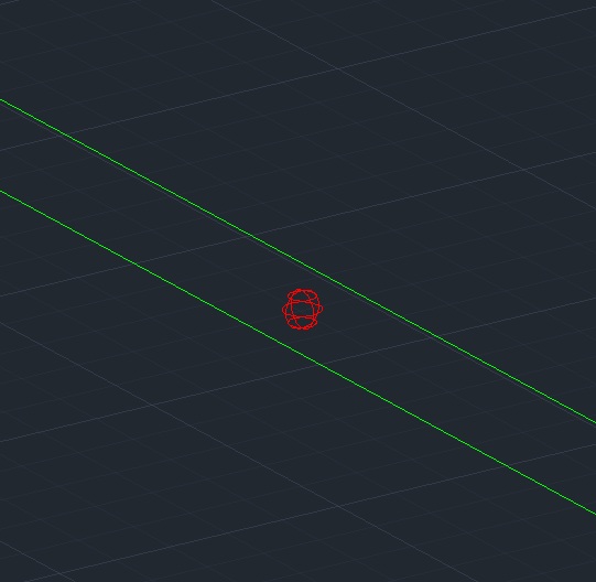

    For this you need to insert iso symbol in the model 3D, the name of symbol is "break point":
    To view this symbol in the 3D model after insert is nessessary activate Wireframe view, there is one small sphere.

    My problem is not placing in a break point just placing one in exactly where I want one. There seems to be no logic where they go, unless it is at a node.
