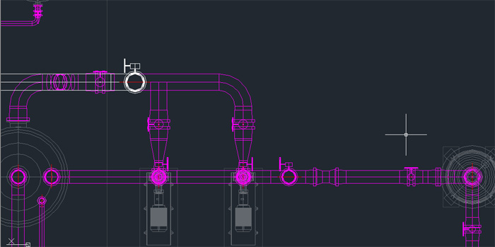

    Valued Contributor
    Posts: 59
    Registered: ‎05-30-2006
    Re: Autocad Plant 3D 2012
    04-18-2012 12:59 AM in reply to: batone79
    hahaha..nice replay!!..
    Yury, do not be angry with what I'm going to say
    You know that is really that ACADP3D is Slow, I worked before with Rebis under Acad and was quickly than this and this a big true.
    I´m working 3 years with this BMW and I think that I know run, change gear, break and Parking, but maybe I´m not as Halmilton in McLaren.
    But remember ACADP3D is not a BMW I think is a Volkswagen Golf.
    ACADP3D need more Agility to be productive, I can not wait 15sec. to change a 3D View. 3 sec to erase a pipe.
    A can not need 3 mouse clicks to find a tool and so much. that you need.
    I think that ACADP3D need get more agility, velocity, stability, make a interface create by users not by psychologists as Ribbon was created and a Big list that you can read in this and other forums.
    Thanks Yury and all my respect for you I know that you are a active member and you help to so much people but if we are critical with ACADP3D we will make a better Software.

    Employee
    TomislavGolubovic
    Posts: 475
    Registered: ‎12-01-2010
    04-18-2012 07:58 PM in reply to: mike.sims
    What are your computer specs? 3 secs to erase a pipe isn't normal.

    Product Support
    jason.drew
    Posts: 293
    Registered: ‎06-17-2010
    04-19-2012 10:51 AM in reply to: batone79
    Some additional questions:
    1. How complex are you models? (equipment, XREFs, etc.)
    2. How are the models divided up? (piping, steel, equipment, etc.)
    3. How well are the models divided? (by line number, service, etc.)
    If you have some screen captures of the models you are using (showing the amount of detail) that would help to troubleshoot as well.
    Jason Drew
    Support Specialist
    Product Support
    Autodesk, Inc.
    If my post answers your question, please click the "Accept as Solution" button. This helps everyone find answers more quickly.

    Valued Contributor
    Posts: 59
    04-20-2012 02:17 AM in reply to: TomislavGolubovic
    Firtst I want to say thanks to Yury, Tomislav and Jason for your interest.
    Well I expose all data requiered.
    Complex of the Models. Some Pumps or Equipment are Downloaded from Manufacturer, but normally Equipment, Pipes, Valves and so on, are Parametrics Drawings.
    Models Set Up. I divided by type and Xref in a Master Drawing to do a final Model.
    My ACADP3D 3DCOFIG... degradation Order is All Checked.
    Thanks again..!!

    Employee
    TomislavGolubovic
    Posts: 475
    04-20-2012 02:20 AM in reply to: batone79
    Click on Manual Tune, what's it say?
