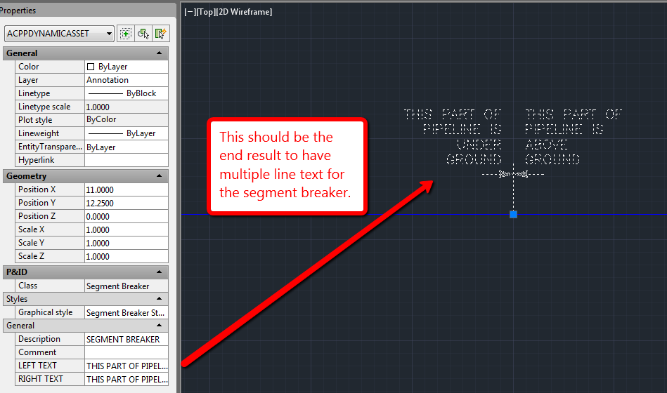

    I created a new segment breaker.  Instead of having the segment breaker pull information from the lines, I want to be able to enter multiline text for some notage.
    I've set up the block inside the base project file, but I'm loosing the ability to edit/access the attribute behind the dynamic block.  The attribute needs to be pulled forward so to speak?  Example, if I insert the block it's an ACPPDYNAMICASSET and uneditable.  If I explode it, it's a boring block but the annotation is available.  I want it to still keep the dynamics, but be able to get into that text.

    I see what Dave was saying with going into the properties and changing it to multiline text. However, it does not give you the option to place a hard return to go to another line of text. So, I think you were correct in that you could make multiple comment fields for the number of lines of text that you want. However, the problem you are going to run into is that for the comment fields that you do not fill in there will be a "." placed on your drawing. Your other option, if you did not care if the text was linked in anyway, would be to just have the segment break come in with no text and create a left and right MTEXT block to insert, explode and then edit the text are you needed.

    Ok, I think I have a solution for you now.
    Create two new properties for Segment Breaker Style, I created LEFT TEXT AND RIGHT TEXT.
    Now, edit the block for segment breaker. Here you are going to have 2 attribute definitions for your left and right text.  What I did was use the existing annotation and just copied it to give me my second one. Then I left and right justified the annotation. Then I went and assigned the annotation format for both as shown below.
    Once both annotation have been assigned, change their properties to Multiple lines "YES" and their Boundry Width to "1.00".
    Now, close block editor and save changes. Apply and OK to exit out of Project Setup. At Command Prompt, type SYNCHSTYLES and enter. Now draw a Primary Line and place a Segment Breaker on it. Once the segment breaker is placed right click on it to open the Properties of it. You should be able to see the LEFT TEXT AND RIGHT TEXT.
    For LEFT TEXT I will enter "THIS PART OF PIPELINE IS UNDER GROUND" and for RIGHT TEXT I will enter "THIS PART OF PIPELINE IS ABOVE GROUND". The end result is shown below.
    I think this is what you were looking for.
