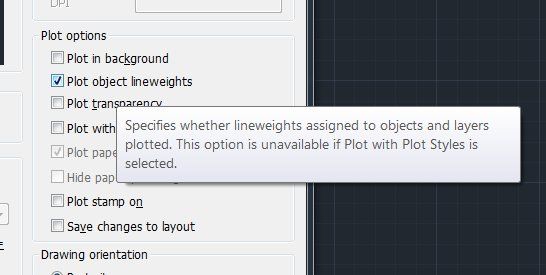

    Please can you try if this option is fine for you?
    Just flag the "plot object lineweights"
    Please, mark any response clicking on "Accept as Solution" button if it answers your question

    Hi Sergio,
    The PLOT OBJECT LINEWEIGHTS is checked.
    And also the PLOT WITH PLOT STYLES is checked.
    It seems that in 2012 it is possible to have both of those checked at the same time.
    Very cool actually.
    When I insert the object from the P&ID PIP Palette, the various thicknesses within that object does not show. It will be only one line thickness used for the whole object. However, when I explode that object once, then the lineweights that is set will come forth also for that object.
    So I wonder if maybe when I go to the "Class" in Project Setup, and then the right symbol (Centrifugal Pump), and then EDIT SYMBOL, that maybe there is some settings there that I need to get right?
    Currently my settings for the symbol/object is:
    Layer: Equipment
    Color: ByLayer
    Linetype: ByLayer
    Linetype Scale: --- Use Current ----
    Plotstyle: ByColor
    Line weight: Default
    If I go into the block (Edit Block) my settings are:
    For the circle:
    Color by Layer
    Layer: Equipment-LW
    Linetype continuous
    Lineweight: ByLayer
    Then I have some lines inside the circle that is:
    Color 8
    Layer: Equipment-LW
    Linetype: Continuous
    Lineweight 0.09
    I have tried allot of various settings in the block and in the EDIT SYMBOL,
    but not found a successful combination of settings yet. Maybe there is non?
    Thank you for the help so far and hope to hear from you.
