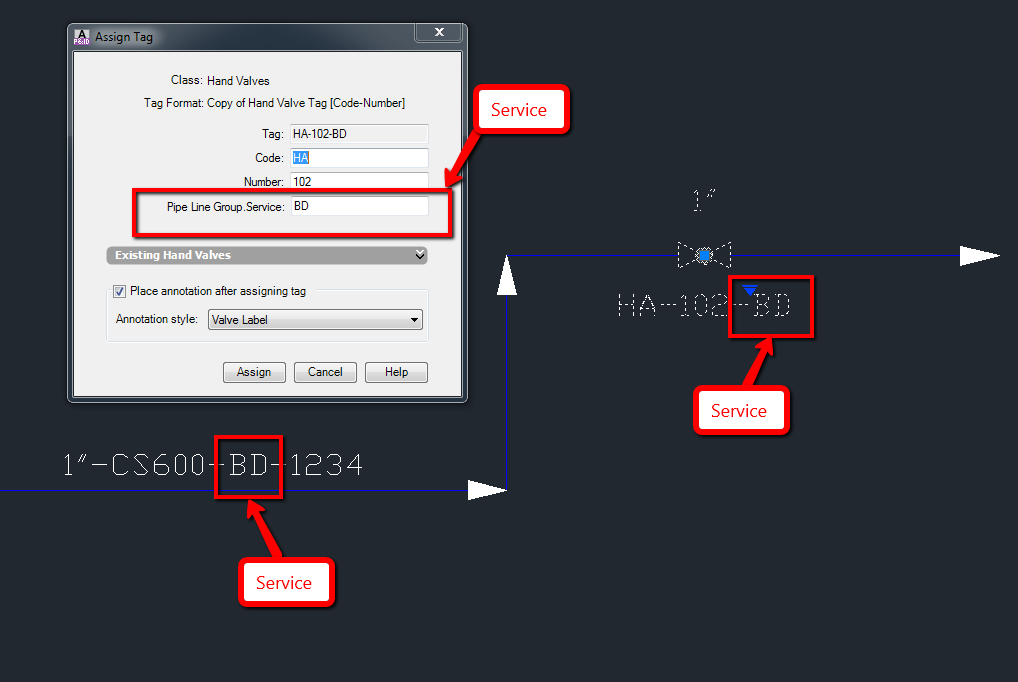

    You could add the service to a valve tag. Go into your Project Setup and access your Hand Valves. Create a New... Hand Valve Tag based off of the existing one there. Rename Format Name: to what you want it to be called. Add Number of Subparts: to 3. In added Subpart select the Select Class Properties button.
    In Select Class Property window, uncheck Use Target Object's Property, In Class: section slect Pipe Line Group. In Property section, select Service and then select OK to close the Select Class Property window.
    Select OK to close Tag Format Setup. Make sure you have added the 3rd Subpart that should now say, Pipe Line Group.Service
    Change the TagFormatName to the tag just created. Select OK to close the Project Setup window.
    Proceed to try to insert a valve. You should have a valve that now shows the Service in the tag for the line it was placed on.
    If you don't want to show the Service you can always go and make a new Annotation that does not include the Service.
    You would follow the same steps for other Inline Assets you are wanting to add Service to.
