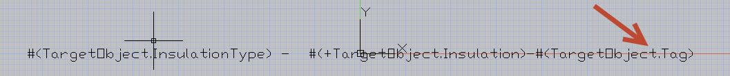

    When I made that statement, I thought you were trying to get it from the ribbon panel.
    In any case, the key seems to be having the TargetObject.Tag property present in the block.  I was able to copy the default insulation label which without that that property will not display in the dropdown.

    Active Contributor
    Posts: 32
    Registered: ‎09-04-2012
    Re: Annotation Style Drop Down List in Assign Tag
    09-28-2012 08:36 AM in reply to: dave.wolfe
    THANK YOU!  Problem fixed!
    The issue was that I kept trying to re-attach a whole string of attributes to my new annotation block, instead of using everything that was already attached/set up in my "Target Object Tag".  For future reference, it may be easier to create a smaller tag format, say with just the line number, so more annotation styles can exist without duplicating the tag contents.  Of course consistancy is key, but now I further understand how this correlates and appears in the drop down.
