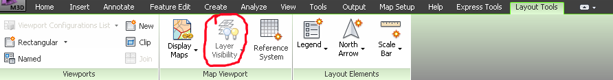

    I created a drawing with multiple layout tabs, so as to create different maps. My display manager consists of data connections & layers added from the Layer Properties Manager. When I activate a viewport from the layout, I want to freeze some of the Data Connection items (like shp files). How can I freeze these items within the active viewport only?

    then you can create mulitple maps (within the dialog _MAPWSPACE) having different stylization or on/off settings of datasources.
    And when you have created a viewport you can use command _MAPASSOCVPWITHMAP to assign a map-config to a viewport. If you haven't disabled ribbons you just have to change to the paperspace of a layout to get the context-sensitive-ribbon for layout-tools ==> and there are the icons for assigning maps/legends/scalebars to viewports.

    I created a new display map in model space, then used the suggested command 'MAPASSOCVPWITHMAP' to update my viewport accordingly. This seems to have worked just fine. Now I need to adjust to the thought process of Map 3D versus AutoCAD. I was very comfortable using 'VP FREEZE' in AutoCAD. So i'm basically doing the same thing in Map 3D, just in model space, verses in the layout...
    I think I understand that now, please correct me if I've misunderstood, or am going in the wrong direction.

    you are at the correct way! For all FDO-objects (connected gis-datasources) you have to use the different map-settings to have the aibility for different viewport-visualisation/stylization.
    For the plain AutoCAD geometry like mpolygons, polylines, lines, blocks, etc you can use either the viewport-depending freeze or you can also use the map-functionality for stylize these objects (as long as they are selectable by rules). So in this case you can use two different ways to work.

    Seems like it would have been easier just to use this:

    The Layer Visibility isn't selectable under the Layout Tools tab. It displays grayed out, as your image clip indicates. How is this activated?
