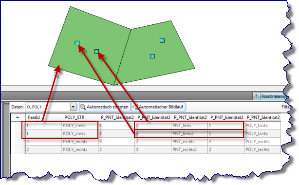

    The option I see is the following workflow:
    • (starting with a polygonal theme O_POLY and a point theme O_PNT)
    • start an overlay-analyses of type "Identity"
    • the resulting theme O_PNT_IDENTITY is of type point and has attached the attributes of both source themes
    • then do a relation/join: source-polygonal O_POLY:FeatID ==> O_PNT_IDENTITY:FeatID_2
    • ==> now you have the source polygonal theme with the attributes of the first point in relation (but be careful really having just one point in one polygon, otherwise you get one polygon listed multiple times in the datagrid, see screenshot (used different names, sorry).
    HTH, - alfred -
