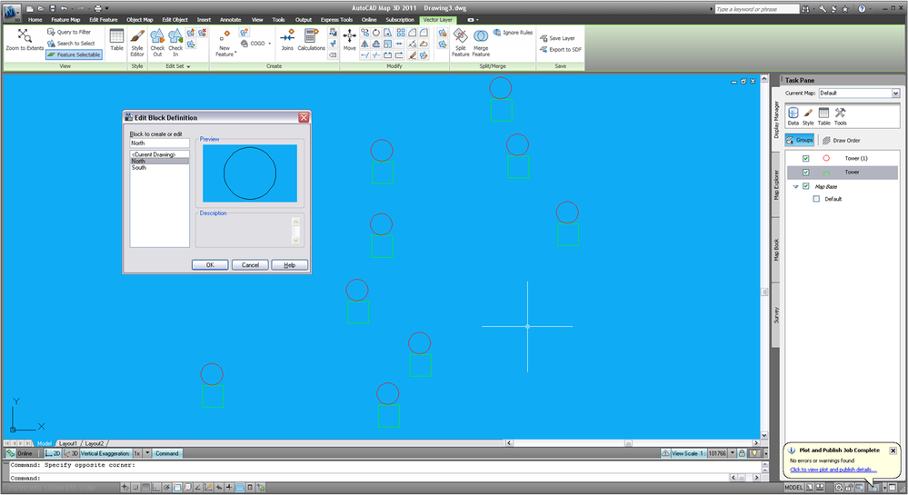

    You could create a block for the symbol that it origin is off to one side, but as a result all points for that style would be off by the same amount.
    The idea would be to offset each so that all would show up if they over lapped. You could just do a Left and Right offset if there are 2 data sets or up, down, left, right, if there were 4.
    Not sure if it will work, im gonna try it now.
    Please use plain text.
    Posts: 228
    Registered: ‎03-25-2008
    Re: Overlapping Symbology
    02-09-2012 12:15 PM in reply to: tjmapper
    Worked like a champ.
    I just added the same layer twice and styled with my 2 new blocks.
