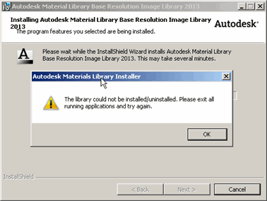

    I tried installing that library manually:
    C:\Autodesk\AutoCAD_Map_3D_2013_English_Win_32bit\Content\ADSKMaterials\2013\ILB\BaseImageLibrary2013.msi
    But it still Fails:
    I wish I could tell AutoCAD Map 3D 2013 not to install this component when installing and I would be golden.
