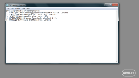

    I have tried this and the additional attributes are visible in C3D but the SDF export seems to ignore them. The lines below show the data I am tryingto work with - there are more fields in the full dataset but these are the main ones of interest at the moment
    #PtENNameDescriptionRegion
    1278200647200CanderiggLochhead/BroomfieldSth. Lanarks

    2. Insert the data to your favorite spreadsheet (in this description I use Microsoft Excel)
    3. Save your pure data to the CSV file called CSV (Comma delimited) but notice that you get a semicolon separator ( ; )

    28. Finally you will get your points from Civil 3D with data from the CSV table, other words you have just inserted all pure data
    If you check the result - geometry matches the description.

    Just worked through this and it worked like a charm - it's not a procedure you just stumble upon though....!!!!:smileyhappy:
