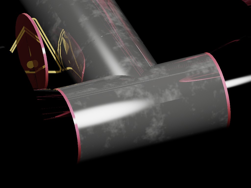

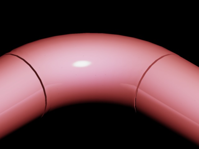

    AMEP NOOB: I need to add an eigth inch weld gap at each connection. I have searched forums, the 3 1/2" thick manual and I am coming up "0". Can some one please lay some wisdom apon me in how to do this?

    Ok, that sucked. But I did find that you actually have to put a -0.125 on each connection point and they over lap each other. I just hope I didn't mess nothing up. I waas batching it and there was a LOT of entries. But, they look pretty cool so far.

    okay, apperantly I missed something.. =0)

    nah, I need the 1/8" gap to show up in drawings. I just threw the render in to to show that which I was getting.
