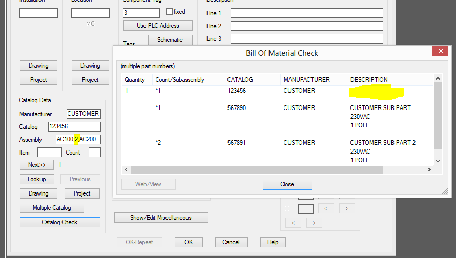

    Hi.
    I've attached a small project, showing the problem.
    On one instance of a component, I wan't to add one extra of a subpart, so I change the assembly code from "AC100;AC200" to "AC100;2,AC200" manually. In the component database, the assycode is set to "AC100;AC200".
    What seems to happen, is that if the assycode in the symbol doesn't match the assycode in the catalog, the description for the "main" part disappears... Not just in the catalog check, but also in the BOM report. Bug or feature?
    See pictures
    Before:
    After:

    If you are keying in the assembly code on the fly, for the flexibility of adding more than one subassembly part to a master part that is not set up as a master, your method should work.  But if the Master does have a code you must match the exact code.  The 2,AC200 to add a second AC200 will not represent an exact match if AC100;AC200 is the code assigned to the master.  Remove the ASSYCODE entry from the master and your code should work.  But if you want a permanent relationship of qty 1 of AC100 and qty 2 of AC200 set the Count field to "2" for the AC200 record in the catalog database.

    So... The answer to my question is that this is a feature?
    Strange though that it's just the description for the main part that disappears, while everything else is ok.
    It just doesn't make any sense that this shouldn't work.

    According to the ACADE 2008 help files, the semi colon is the correct way to seperate different sub part codes. and the '2,' before the assembly code is the correct way to add multiple sub parts.
    If this has changed in later issues it should be documented.
    I have noted that if you make a change to the catalog entry, you have to select it, exit to the component edit screen and then do a second lookup and selection to have the correct data disply in the catalog check screen.

    This seems to be "the problem", and I have trouble seeing the logic here.
    If an item in the catalog database has an assycode, the assycode in the edit component dialog MUST match the catalog.
    If an item in the catalog database has an empty assycode, the assycode in the edit component dialog can be whatever you want. Empty og something you've specified manually.
    I see that I works this way, but can't see any reason to why it should be like this? The flexibility of the program would be much greater if one could specify whatever one would like in the assycode textbox.
