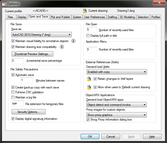

    I deleted 50,000 files from the temp to empty it a bit.
    with acad e 2012 on w7
    in the options :
      file safety precautions
      -automatic save 10 or 2  or 1 minutes between saves
      -file extention for temporary files
       ac$
      automaic save file location
      c:\users\username\appdata\local\temp\
    in this location are :
      ace script files
      1 undo.ac$
    a few :
      tmp
      cvr
      mdb
      lsp
    files
    but no opend dwg files *.ac$
    Is autosave working for sombody with acade2010 ?

    Here are my options Open/Save
    I used the extension qqe just to test, but no qqe files in the temp.
    The automatic save path is :
       C:\Users\USERNAME\appdata\local\temp\
    And the bak file is normally only in the directory where your dwg is, but now it saves it here to.
    But John Q why do a auto save on the network, as you see we use a local profile, and the IT dudes want as less traffic as possible.

    One thing to keep in mind.
    The AUTOSAVE file are only kept until you save the dwgs you have open or close the dwg without saving.
    At that time, they are automatically deleted.
    I've been caught by that, had autosave on and made some changes. Went to close the dwg and hit NO to the save question by mistake. Unfortuanetly I couldn't use the autosave file to recover the work as it was automatically deleted.
    About the only time you would be able to use the autosave file would be if the computer lost power suddenly and there were autosave files in existance for the dwg you are working on.
    Regards Brad
