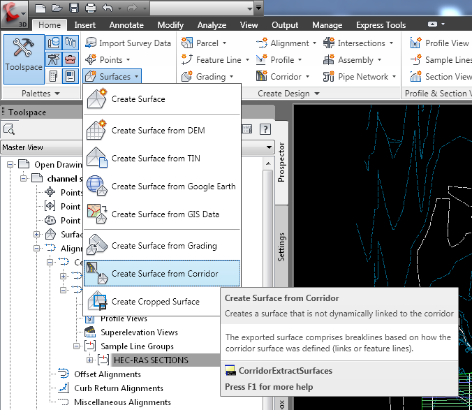

    I had a client with the same issue. I think I narrowed the issue down to the fact that the surface that was being exported was created from a corridor. I created a new surface from the corridor surface, sampled that new surface, and it exported just fine.
