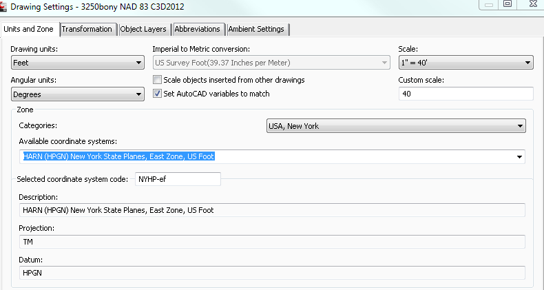

    *Expert Elite*
    AllenJessup
    Posts: 4,608
    Registered: ‎05-21-2003
    Re: Z distance in inches not feet
    12-11-2012 12:24 PM in reply to: ajfernandes
    Make sure that you are setting your units correctly in the Drawing Settings. Go to the Toolspace and on the Settings tab - Right click on the active drawing and select, Edit Drawing Settings. Set up your units on Units and Zone tab and check 'Set AutoCAD Variables to match'.
    Here is how I have mine set up for feet
