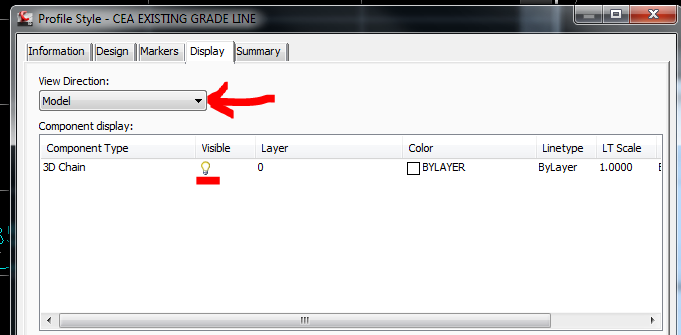

    Allen and John have talked about turning on the 3d chain in the style , exploding the profile and being left with the profile in plan

    if you explodethe chain remember to do it to a COPY
    Because it explodes the whole profile.
    I don't know what that means.  What & where is 3D chain?  Not supprisingly it doesn't show up in the help.
