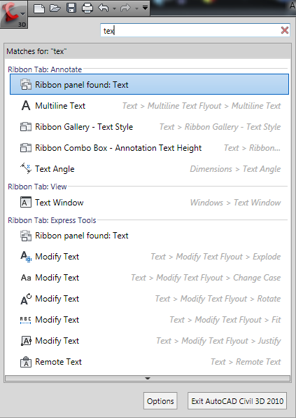

    TEXTEDIT command can be accessed by command line. One good tool for transition from menus and toolbars to ribbons is search box where you can start typing command and program populates the fields with available commands. See image:

    Yes, I know the command can be typed at the command line.  Your screen capture shows the text panel, but I do not see the textedit command on that panel.  Seeing how the ribbon is layed out, it would make since to have it located on the modify panel.
