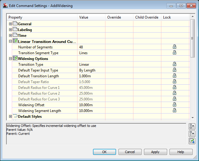

    Hi Steve,
    Your alignment drawing worked perfect. Could you explain how you actually went through the steps of creating the offset alignment and then tweaking the widening. Did you use some type of constraint or do it manually?
    Cheers,
    Aaron
    Please use plain text.
    *Expert Elite*
    sboon
    Posts: 1,440
    Registered: ‎11-08-2005
    Re: Transitions Between Assemblies
    01-03-2013 04:30 PM in reply to: aafulton
    Start by creating a very basic centerline, just a straight line from your proposed start point to end point to get started.  Before you create any offset alignments you likely need to edit the default settings for the Add Widening command.  Otherwise your transition segments through curves don't work very well.  The default settings can also cause the command to fail, because the segment and transition lengths won't fit within the overall length of your alignment.  Here's what I'm using for the example drawing.
    Use the Create Offset Alignments command from the Ribbon then select one of the new alignments and use the little cyan + icon to create the default widening.  Once that's done you can select the alignment again and pick on the white dot in the middle of the transition.  This should turn on two new cyan grip points which allow you to drag the start and end of the transition.
    You cannot move them to the absolute ends of the centerline alignment (if you do then the transition disappears and you have to recreate it) but you can use the station-offset transparent command to get them close enough.  The idea is to have that one transition cover the entire length of the centerline.
    Once you have all of that done you can go ahead and start editing the centerline to add PI's and curves etc.  Note - you can also try to do this step first, but I've sometimes had difficulty creating the widenings if the centerline already has complex geometry.

    Great Advice!
    My problem seemed to be fixed by changing the default settings.
    Thanks to everyone for their spectacular help.
    I KNEW there had to be some way of changing that! Thanks Steve!
