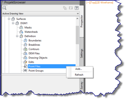

    follow these steps:
    • create a new surface
    • open the surface-item in the prospector
    • open definitions
    • right-click on "Point Files" ==> ADD
    • chose the file and the format of the file to get the data assigned to the surface (I guess the format is named like NEZxxxx)
    It's the standard procedure, so I don't know if that answers you question

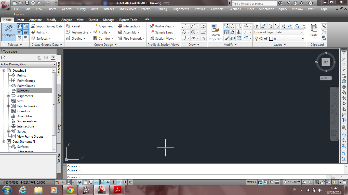

    I dont find any DGM layer in auto cad civil 3D 2011. Please could you help me find it.
    BTW watercad accepts DXF files so please attach that surface you have made if u can.
    As Brian already mentioned you don't find DGM because you don't have the German version. What is DGM in my video is "Surface" on your UI (in the prospector exactly that option that you had already selected when you did your screenshot).
    There you have to right-click ==> "Add" .... and so on (following more the positions I used in submenus than the menu-names).
