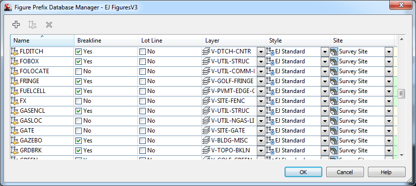

    Sounds interesting. One question. Can I import a fence line into the surface as a random feature? The other program I use allows me to draw lines between the fence shots but when they get imported into a dtm the vertices are treated as random points and the line is just a graphical line. There are lines we survey (tree lines, fences, and certain area boundaries) that produce a graphical line in field to finish but create random dtm points.

    If I understand your question correclty, then that's what happens when you include your Fence shots in a Point Group in your surface definition, and you have Breakline=NO set in the Figure Prefix Library.  The Fence shots get included in the DTM if they're part of the Point Group (or one of the Point Groups) you use to create your Surface, so if you want those points in your DTM, just make sure they're part of your Point Group.  The Fence linework would be drawn between the points, as a Survey Figure.  But the Survey Figure only gets added to your Surface as a breakline if you have "Breakline=Yes" in your Figure Prefix Library.
    Here's an example:
    Notice how the Fence code "FX", along with the Fiber Optic Locate code and Gas Locate code are set to "Breakline=No".  This means they'll get linework drawn, but when I use the "Create Breaklines..." command to add my breaklines to a Surface, those lines will be ignored.  And that's typically what we want, since with things like that, the field surveyor might take shots with a very wide spacing.  And we don't want a bogus 200' long breakline between fence points, for example.
