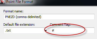

    When importing an event, my point descriptions are cutoff at 16 characters.
    Is there any setting to increase this?

    I'm not really talking about DescKeys but surveyors would need more than 16 chars in the point description when using DescKeys anyway. Ex: "BLDG B  RPN1000 /#123 EXAMPLE ROAD"
    I'm speaking of the actual point description.
    I just visit another user (Civil 3D 2012 on Win7) and they can have at least 40 chars.
    I beginning to believe it may have something to do with Win7 (true 64bit).
    I'm not finding. in the 2013 help. where it lists valid characters to use in your input file, nor do you mention what kind of file you are importing (fieldbook, point file, etc.). But I think your issue comes from the # character in the description....most, if not all, of the stock PointFileFormat styles use the # character as a comment tag, so anything following it is ignored.

    I was importing a FBK.
    When speaking with IT, I imported a ASCII file and all the characters were there!
    It turns out the Survey Data Collection Link (found on the Home tab under Create Ground Data) was reducing the characters when converted from TDS .RAW to FBK.
    Thanks for the help everyone!
    @Jeff_M: Thanks for pointing out that I need to remove/change the comment tag for ASCII import.
