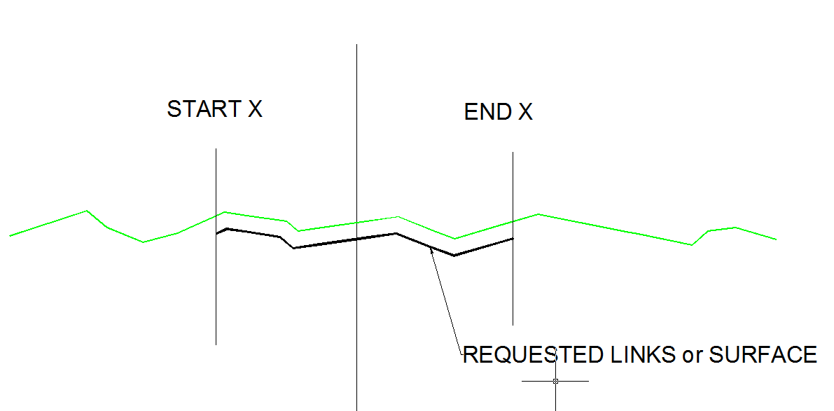

    we are missing tool in SAC  for stripping a surface exactly the same way how Stripping Pavement or Striping TopSoil works. There is no tool to copy and vertical offset part of the surface. I found out some workaround with Point Delta X on Surface and then vertical Offset, but this is very complicated and I am not able to follow each peak of the surface. Do you have any effective idea? Surface link is not suitable for Topsoil stripping.

    martin.folber
    Posts: 17
    Registered: ‎12-25-2010
    Re: Subassembly Composer - Stripping surface tool
    11-09-2012 05:41 AM in reply to: KMercier_C3D
    Hi Kati,
    11-09-2012 06:20 AM in reply to: martin.folber
    As Kati pointed out, that is exaclty what the surface link was designed to do. It will follow a surface between two points and with an optional vertical offset.

    martin.folber
    Posts: 17
    11-09-2012 11:43 AM in reply to: peterfunkautodesk
    Thanks Peter and Kati,
    I made a fool of myself little bit... Maybe the picture in SAC help should be more illustrative. It is not clear, if there is one link (segment) or more segments of stripped surface.
