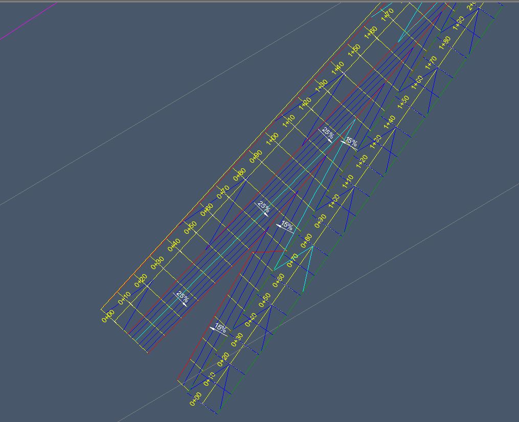

    Omit the crossing daylight links through your Section parameter editor.  See the two pictures below.
    This stinks that Civil 3D does not have the intelligence to clean up intersecting Daylighting in Corridors. Especially, when using two Baselines in the same Corridor!

    I figure out the best way to do that,
    1- Create surface from Baseline 1
    2- Create a fetureline form the surface of Baseline 1 that located in the intersection between corridor 1 & 2
    3- Create subassembly that target featureline by using linkoffsetandelevation
    Any queries will be wellcom

    I take back my "C3D stinks" on this grading cleanup issue with Corridors. SAC is making me me eat those words.
    I created a subassembly in SAC that cleans up intersecting daylight links between two Corridors. You can see below, between two crowned corridors, the daylighting links catch into existing ground, and stay apart up to about Sta 0+70. The corridor on the left is daylighting at 25%, and the corridor on the right is daylighting at 15%.
    After that,  they are intersecting and cleaning up with each other.
