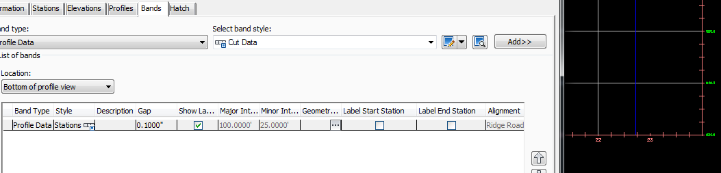

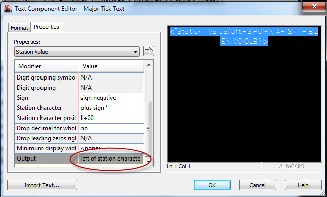

    How do I revise the profile stationing from 100+00 to display 100.
    Also is it possible to remove the begining and end stations in the profile view
    I have attached an example

    Edit your Pofile View Style.
    go to the Horizontal Axes Tab, where it says Tick label text click on the edit button on the right (with an 'A' on it)
    Hightlight the text that is there, and look at the options on the left.
    At the bottom (in my version anyway) is the 'Output'
    Switch this to say 'left of station character' and then click on the arrow at the top to replace the text with the change you made.
    Click Ok, Ok.

    And to turn off the start/end station label, turn off the bottom axis labels and use a Band to label the stations instead. You can then determine to use the start/end stationing.
