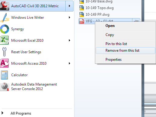

    I have seen many cases were customers wanted to remove DST files which do came back if Civil 3D is still running. So my suggestion how to remove them was in that light. I was not even sure if that is the intent. Obviously this is not the issue neilyj is having. Sorry if I confused soem of you. :smileysad:
    I found that you may manually remove the item by right-clicking on it. It is manual process but it works. See image:

    Almas, that looks like a new feature in 2012.

    05-25-2011 07:37 AM in reply to: Sinc
    No, that looks like Window's Start menu....not the file list in C3D.
