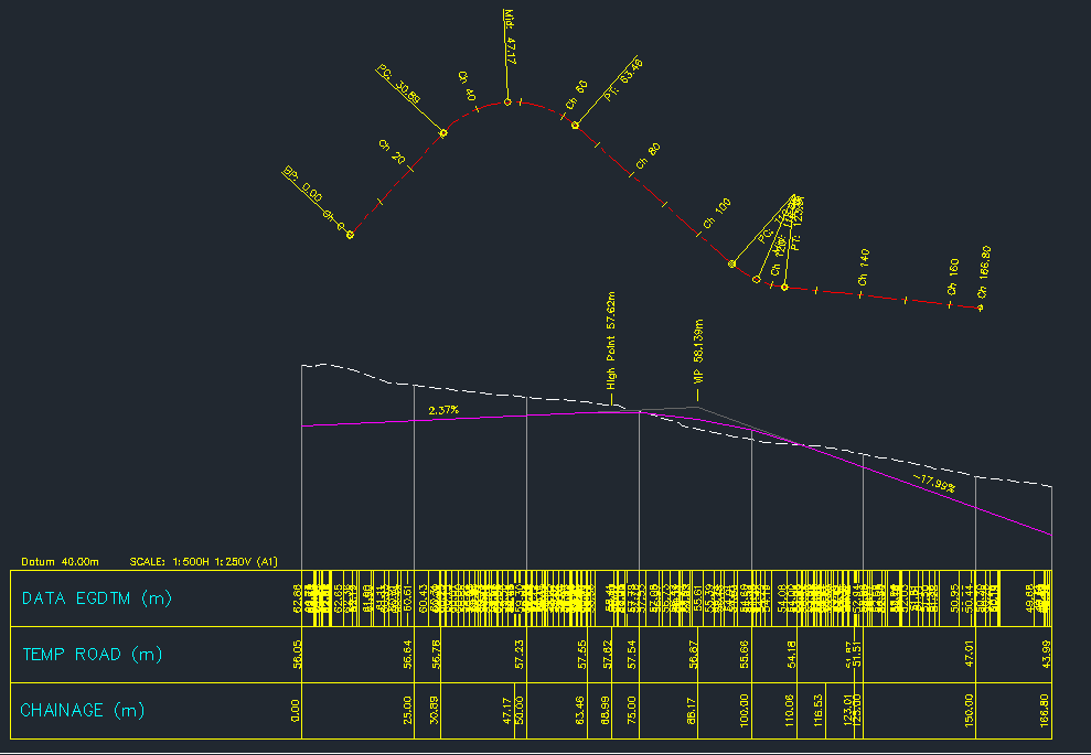

    Hi all,
    I am creating a longsection and I do have a question about a settings on one of my band style.
    To simplified, my task is to create a longsection of a new road. So I need to show the levels of the existing surface, proposed level and chainage/station and other road definitions.
    I created the alignment per what I am instructed and then created a longsection/profile using "CREATE SURFACE PROFILE". Then I used the "PROFILE CREATION TOOL" to create my proposed level of my road.
    Everything looks fine EXCEPT for my "PROFILE BAND STYLE" for the existing surface. What I want is to show the existing levels at the HORIZONTAL GEOMETRY POINTS and at the VERTICAL GEOMETRY POINT same as where the proposed level. HORIZONTAL GEOMTERY POINTS works (I checked this by turning of the other display on that band). But the VERTICAL GEOMTRY POINTS seems getting its value of all the VGP of the existing surface and not the proposed level. I just want to show the existing level at where is the low/high point of the road, start, end, and PVI of the porposed profile (hope I explain it well).
    Please see the attached image. I removed the other road deifinition to make the profile simplier.
    Existing surface --> DATA EGDTM
    Proposed road level --> TEMP ROAD
    Could anyone point me what setting/style I missed? Any suggestion or comment is much appreciated.
    Many thanks,
    Eric

    I know what are you pointing out with your instruction and that's my procedure. And to check my style, I tried to create a new style and follow your procedure just to verify what's wrong with it. But again without luck.
    I place the existing surface on PROFILE 1 & proposed on PROFILE 2 per your instruction.
    Here's a snap shot on what I got:
    1. This is where the VERTICAL and HORIZONTAL GEOMETRY POINTS are turned off for the DTA EGDTM (exising surface). You can see that the level are just for the regular intertal (MAJOR STATION) only. Which is by the way on every 25m.
    2. This is where I turned on the HORIZONTAL POINTS for the existing surface which got the correct levels per geomtry points I selected (TANGENT-CURVE INTERSECTION and CURVE-TANGENT INTERSECTION)
    3. And here's the problem when I turned on the display for the VERTICAL POINTS (I turned off the HORIZONTAL POINTS to verify it will get the levels only at points of the proposed). And I only selected the VERTICAL POINT INTERSECTION on the geometry point.
    I will try to play it around to solve this as I think there should be a solution for it.
    Any more comments and suggestion is all welcome.
    Cheers,
    Eric

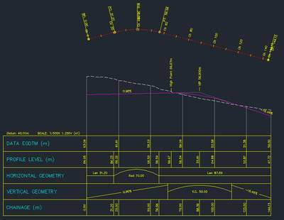

    Awesome! Problem solve.
    I think I know where's the problem lies. I forgot not to change the PROFILE 1 on the GEOMETRY POINTS tab to my proposed profile.
    And change the Profile 2 into my existing surface. And here's the resulted longsection.
    Just to summarize and share what I understand from here:
    PROFILE 1 --> uses the point where do you want to have labels and you can edit the GEOMETRY POINT (Vertical and Horizontal) to suit what points you wanted.
    PROFILE 2 --> uses the value of the tin at the point where you specifed on PROFILE 1
    I wish Autodesk renamed this Profile 1 and Profile 2 into Label Location and Profile Value or similar to make it clearly.
    Hopes this will help other users having the same question/problem. And thank you to the CIVILFF in giving me an idea on using profile 1 and profile 2 seperately on the bands as before, I don't mind what's in there as I usually use same value on it. Thanks mate.
    Cheers,
    Eric
