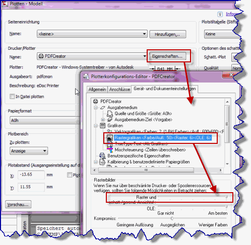

    besides the option to go via DWF as mentioned by antoniovinci (what I also would prefere) you also have the option to reduce the output-quality in the plotter-properties-dialog:
    That helps to reduce the amount of memory used during plot.
    -alfred -

    I already know the "lower-quality-solution", but I need the quality.
