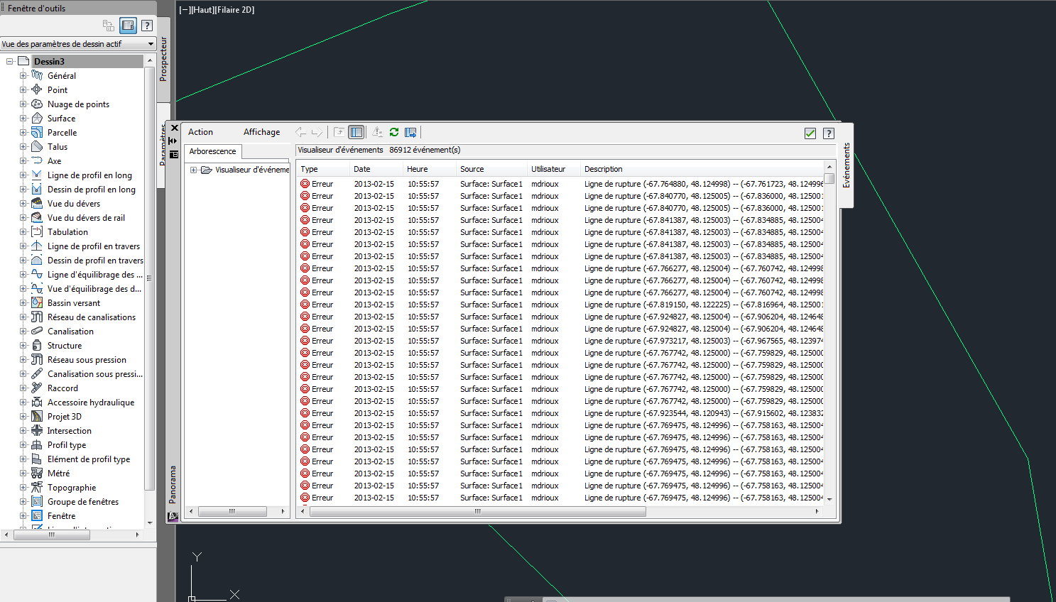

    I do not have a elevation criteria on the GIS's side. I have Zmin and Zmax ( which are the same value, and act as elevation in the GIS). So I tryed to specify elevation to Zmin or Zmax. The results is the same,
    " error : 86 912 events " .. Creation.png

    It looks like you have created the surface successfully using the Altitude.  The error messages you are getting are because of Crossing Breaklines.  You will always get these messages when creating a surface from a .shp file.  You can ignore the messages.
