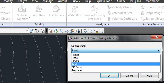

    I see now...
    Assuming all the text values have the same offset (X,Y) from the required point then do the following
    Quick select all the text
    Move the selected text so that the insertion point snaps to the point node
    Then, after creating a new surface, Modify > Add Data > Drawing Objects > Text
    That should create the surface for you

    Sir, i thank you much for every single point on my just created surface! This was 1000 times faster than the way i was going to do it.
