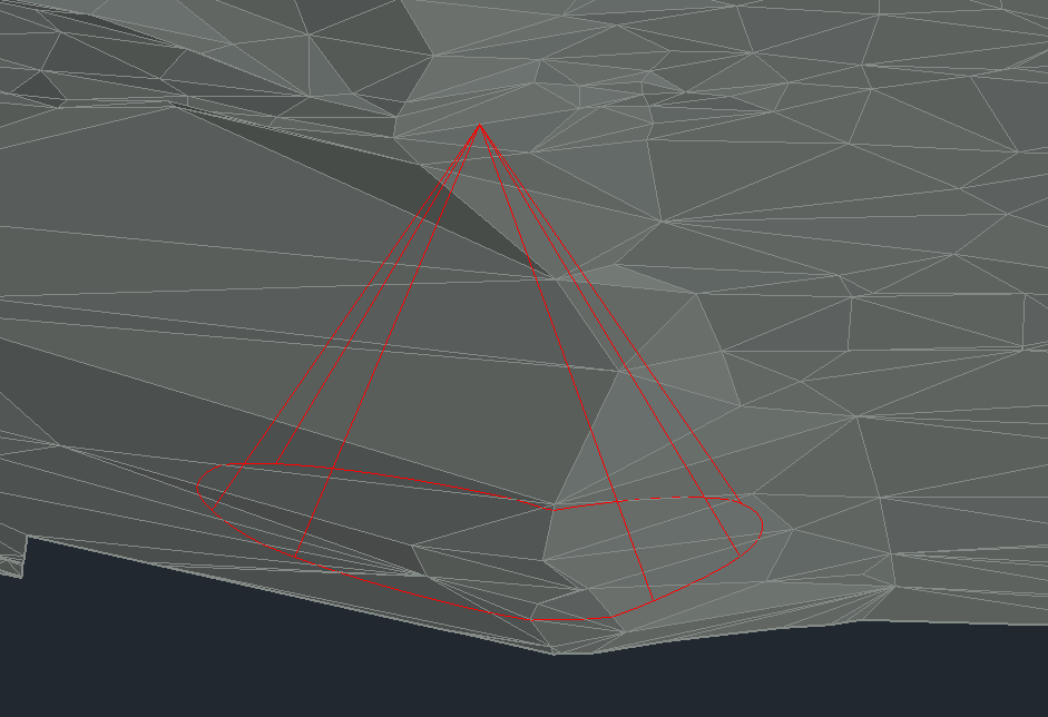

    The intersection of the sphere and surface would be an arc draped onto the face of each triangle of the TIN.  The problem is that none of the arcs would be coplanar, so where they intersect at the TIN lines there would have to be a kink.  I tried a few tricks to draw the arcs, or to trim things at the intersection with the sphere but I couldn't figure it out.
    Instead of a sphere would a cylinder work?  The intersection of a cylinder and a TIN would be a circle, which can be converted to a featureline and then draped onto the surface.  This gives you something to draw your line to.
     Here's what it looks like when I tried it.

    You don't need the cylinder, just a circle around your point of interest.  Actually you need to draw an arc of almost 360 degrees, because a circle cannot be converted to a featureline.  Once you have the arc use the Create Featureline from Object command, with the Assign Elevations button checked so that it will be draped onto your surface.
    Once you have the featureline you can draw as many lines as you like from the center point out to the edge - then you can select all of them and change their start elevations to match the aircraft location overhead.
