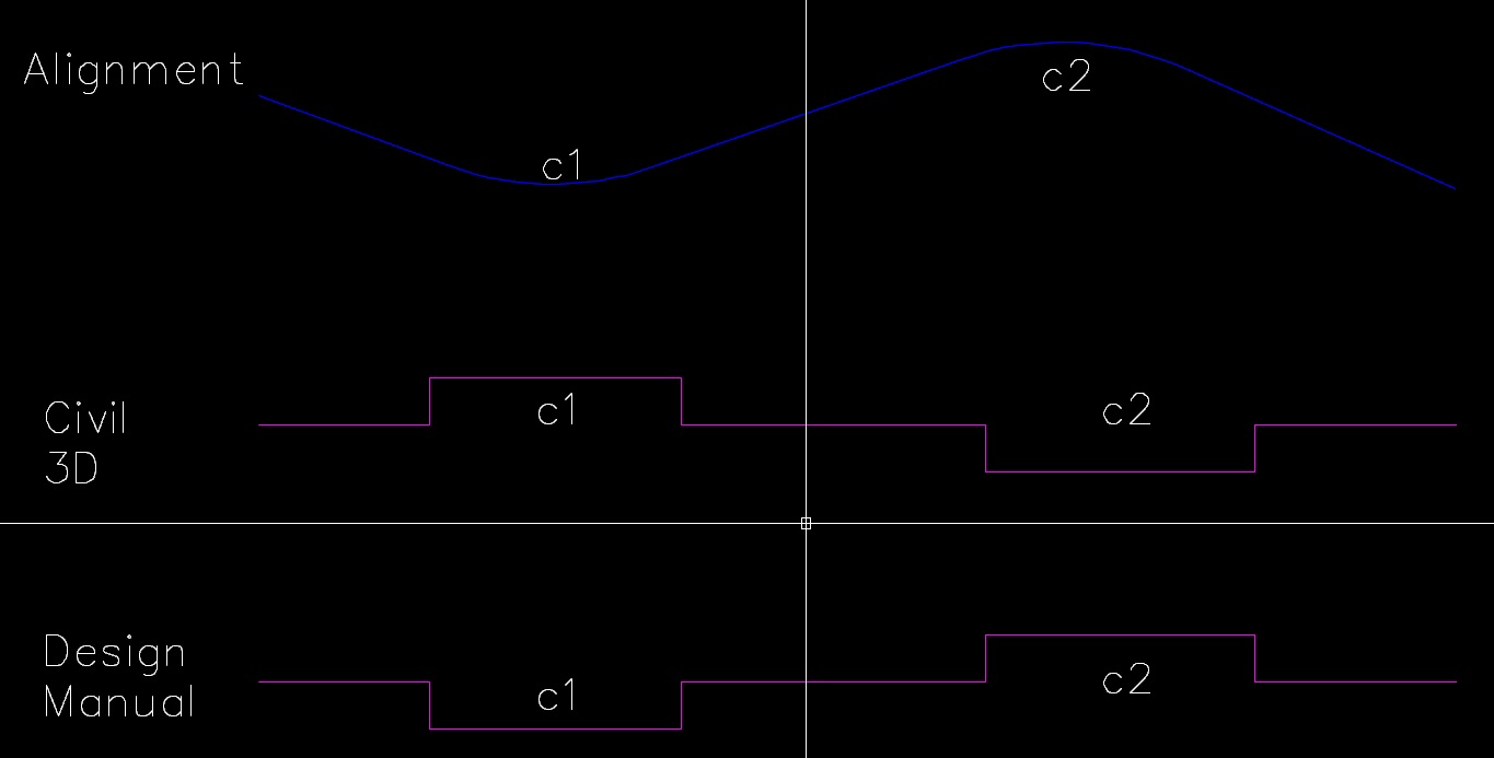

    I have a question about horizontal geometry data band. Here in Peru, the Manual for Road Design says that the horizontal diagram will be something like this image.... is it possible to do this in civil3d??.

    When I draw my alignment from left to right it produces a geometry band (using all the defaults) that match the bottom band in your picture (matching the standard in Peru). Curves to the left drop below the line, curves to the right rise above the line.

    So sorry, there is a mistake in my picture!!! Change the text "Cicil3D" with "Design Manual". Thank you.

    This is the manual DG 2001 Road Design. Mi question is if it is possible to do a mirror of the aligment diagram (maybe creating a new style) along the horizontal because here in Peru the diagram is in different direction that civil shows.
