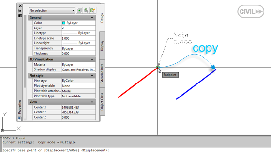

    You can add a note label that includes the Point Elevation to any object (e.g. a line or a polyline)
    with any elevation (e.g. the Elevation = 0) and copy or move it from the end of this object
    to the destination object with the Elevation (e.g. of a line or a polyline).
    1. Select the Note Label and type the Copy command:
    2. Select any point of the first object (e.g. the Endpoint) and copy it to the destination point of the second object
    (e.g. the Endpoint):
    3. You will get the Note label with the Elevation Point which displays a proper elevation value:
    This method works in Autodesk Civil 3D 2012, 2011 and 2010.
