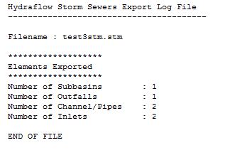

    Reads as a sucessful Export from SSA, but nothing populates in Hydraflow Storm Sewers when opening the STM file exported from SSA.

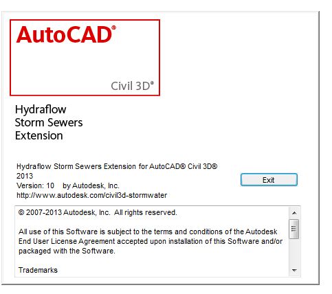

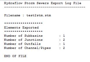

    Thanks dgordon. Please see STM file attached.
    Here is the Export info from SSA and the version of Storm Sewers I'm using.

    Dear Fred,
    Thank you for your patience. I would like to inform you that the issue with nothing populated in Storm Sewers extension for any STM files exported from SSA 2012 & 2013 is a known issue to the development team and they are working to resolve the issue. Per process I will be closing this case and this does not mean your case is forgotten, but it is in pending status while the development team works on this issue. Please do not hesitate to contact us in the future with any and all questions you may have.
    PS: If you still have SSA 2011 Stand-alone installed, you should be able to open any version of SSA model and export the model to STM format without any issue.
