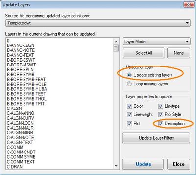

    Here is the source. The CAD Standards COM interface is pretty clunky.
    I've now written a different .NET application that loads a DWT or DWG file as a standards file and allows you to update your layers, including layer descriptions and blocks in the current drawing.
