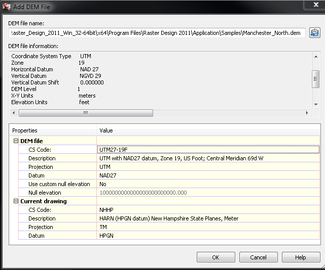

    Here is the problem I am having. Here are the steps I took:
    1)  Assigned a coordinate system to the drawing
    2)  I created a new TIN surface
    3)  I added the DEM surface from the Prospector (Surface - Definition - DEM files)
    Here is the problem:
    4)  (see attached) attempted to change the coordinate system of the DEM but unable to do so.
    Any suggestions? Thanks in advance.

    If you click in the field twice, you should get the ellipsis button.

    Thanks for the quick response. Unfortunately that didn't work. I know what I did wrong. I didn't add the coordinate system when I initially added the DEM file. When I went into the properties to add the coordinate system later, I didn't have the option to do so. So to whomever read this, make sure to add the DEM coordinate system with the DEM file at the same time. Otherwise your DEM surface will come in some random location and size :smileyhappy:
