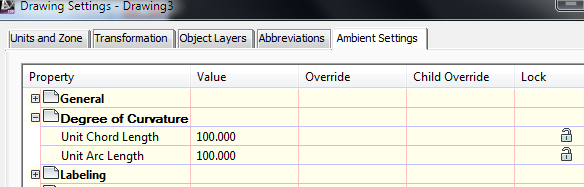

    Here's a setting to check, since I just noticed the OP's unit arc length is 0

    OK, so looks like there is a bug when selecting the curve. If you input the values to calc a curve, without first selecting a curve, the DoC works correctly. As soon as you select an arc in the drawing, the unit arc length gets set to 0.
