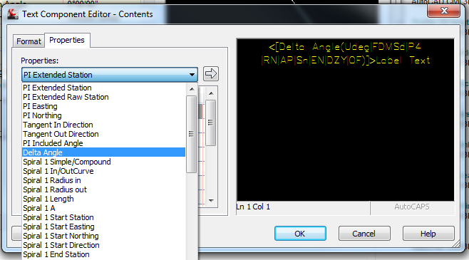

    Using C3d 2013.  I could not find this information anywhere in tutorials, discussion boards, or blogs.
    Specifically, I am looking for a way to place the deflection angle of the PI of an Alignment in the label of a structure part that references said alignment.  But PIs aren't an option when I select Reference Text type.  Common sense tells me it would be under Alignments, but none of the PI data is an option of the Contents' Text Component Editor.  I couldn't find it under any of the other Reference Text types either.  I can pull the station value from the referenced alignment, is there a way to get it to tell me the deflection angle at the PI it sits on?  Or even the difference in the instantaneous direction just before and just after the part?
    I know listing the deflection angle of a PI is possible, as I have seen it in several examples of labeling alignments.  I just want to place it in the label of other objects.
    An added bonus to who can tell me how to display LT (to represent left) and RT (to represent right) when the deflection is positive or negative respectively.

    After further review Delta is and OOTB parameter for alignment labels.
    As for expressions:smileysurprised:n the settings tab inside most label styles the bottom node is expressions. Here you can create pretty much any mathmatical operation on the data of a given c3d object. You could create 2 label components for left or right. using an if statement for plus or minus you can set the label height to zero for one condition and plot height for another condition ther by controling which side actually plots

    Well we're starting to get somewhere, but from the documentation I've read, C3D labels only recognize expressions of the entity (or sub entity) you are wanting labeled (i.e. Alignment labels can only recognize expressions of Major Stations, Minor Stations... Station Offsets, Lines, Curve, Spirals... or any of the Expressions listed under the Alignment folder in the settings tab).
    I want a pipe network part to display the alignment expression.
